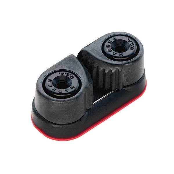

Since you're on an outfitting roll here is an idea to consider.
Use a Harken cam cleat to restrain the painter closer to you, within reach of your sitting/kneeling position. This allows stepping out of the canoe while the hull is afloat and walking the canoe to the landing. The idea came to me thinking of their use on sail boats. I daisy chain the excess line so I have just the length I need. If you need to pull on the painter to drag the cane, the daisy chain is an excellent handhold.
My next upgrade will be to drop the cam cleat below the gunwale. Add a wood block below the thwart and mount the cleat there.
What size is your cam cleat and line? I’m using 1/4” line which seems to be the max size for the smallest cleats, and the smallest size which works in the larger cleats.
The line in the photo is 5/16”. The carbon cam cleat is a Harken model 365 which can accept line from 1/8” to 3/8”. Stronger cam cleats that accept larger line are also available from Harken.
Thanks. I was waffling between that one and the micro. I don’t think this application called for the hard-anodized aluminum version.
This thread motivated me to make the effort to move the cam cleat. I took some left over thwart scraps, made a block and mounted it.. I’ll need to try it on the water, but it looks like it should work.
