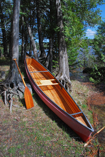

Now for the bad news. I was cutting a very temporary seat platform from 1/2 ply last night and I found that I cannot fit it into the hull!! That beautiful creased tumblehome makes for a gunnel width about 4 inches narrower than the required seat frame width...I did not see that coming!!
So, again, I need to tweak the seat frame to allow for insertion and subsequent reversals....somehow.

It should still fit... your cleats are back of the widest part of the boat, slide it in on an angle then back to the cleats level. The taper messes things up, I imagine the back is skinnier than the front which would mean it won't fit the cleats right when reversed for portaging?...
Just thinking here (a dangerous activity for sure) ... the seat/yoke frame might have to be rectangular. In that case, the forward cleat might have to be built out toward the middle of the boat, like a shelf. Given everything else that's gone into this boat, it shouldn't be too hard to do.
I did wedge in a very temporary plywood seat last night...I had to force the hull wider to fit it in.
No amount of juggling, positioning, sliding would allow that seat platform to pass the gunnels. Even by burying the one edge into the bilge at the centerline of the hull (fore to aft) the seat platform still will not clear the gunnel.
The very feature that I was so impressed with (that creased tumblehome) has now thrown me for a loop.
Not to worry, there is a solution to all problems, it just may take some more time to discover the optimum solution. in the mean time, I'll paddle an ugly, unfinished hull with a plywood seat...
Here's the answer: Install two rails, one across each end of the cleats. They'd provide a mount for the seat/yoke, which would not have to span the entire distance. It should be a piece of cake to flip the thing without the tumblehome getting in the way.

I had the Kite out this weekend, even though it isn't quite finished.
One of the group we met up with had several hardwood framed, caned seats, I tried one for fit and VOILA!! it fit great!! Sure was better than sitting on a piece of 1/2" plywood. I couldn't get that plywood to fit inside the hull unless it was cut really sloppy...somehow, the caned seat frame slipped right in.
Paddling impressions:
1. Speed is OK, plenty good enough for the intended use. I won't win any races in it, but then again, I probably don't need to!
2. Seaworthiness is outstanding. I intentionally breached in 18" rollers, the hull just doesn't care. When quartering oncoming waves, the flare just sprays the waves aside, not a drop in the boat.
3. Stern hook, that annoying and sometimes dangerous habit of a hull to twist into rollers when taking wind (and waves) over a rear quarter, is nearly non existent. Certainly not a problem.
4. Maneuverability is outstanding as well. The bow responds sharply to all commands.
5. Tracking is surprisingly good, considering the ease of turning.
6. Comfort gets high marks too. It is a very calm hull, despite the rather narrow beam.
I did paddle a small piece of Class II in it, it effortlessly swept into eddies and was very easy to control. Plenty of buoyancy up front made for a fun ride.
I haven't yet paddled it with a full load of gear in it, but my stuff usually weighs no more than 30 lbs...I can't imagine it will handle much differently.
So, except for duplicating that hardwood framed caned seat in CF and foam, and the final clear coat, this boat is done.
I am extremely pleased with the performance, satisfied with the weight, and love the aesthetics. For me, it's gonna be a keeper!!

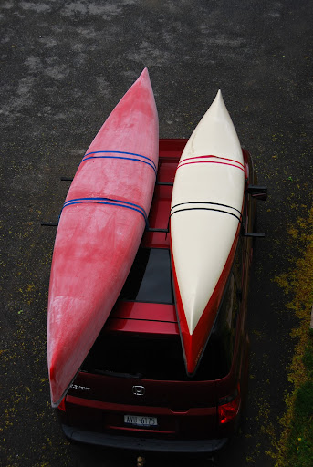

On the car next to MDB's Swift
