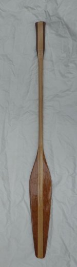

Seeing this post reminded me that I needed to make a new paddle for this season. Finished this one off last night, just needs another coat or two of finish.The blade design template was copied off a paddle I purchased a few years back. Good for rivers where I spend most of my time.
Solid ash shaft, butternut and poplar strips.

Ok, that look awesome!! I might have to still that from you!! I have done tips like that but using only G-Flex, they are pretty good as wear strips, but not great if they get jammed in between to rocks...

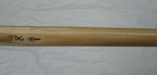

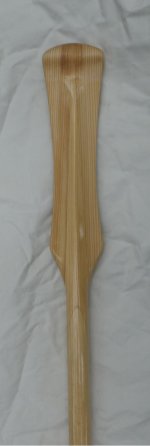

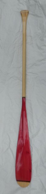

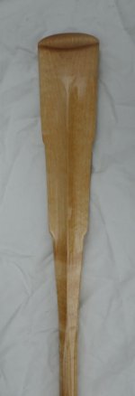

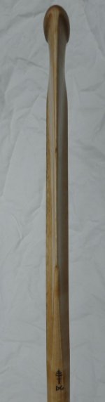

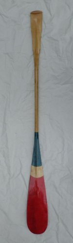

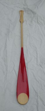

So I finished and refinished a few paddles lately, one is a birch paddle I made for my self, the other one is one a friend of mine bought form me a couple years ago and I needed to refresh it for the summer. I also made a nice deep water paddle for my niece, and fixe the one my wife broke the grip last fall...
I still don't know why the pictures don't load the way I picked them... ho well...
Info bellow the pictures...(missing some stuff that doesn't show...)
So here it is: The Birch paddle, is 66" long, the blade is 28"x 6.25" weight in at 1.05kg it has a reinforced tip.
The small sitka spruce for my niece, is 54" long, the blade is 25"X5", it weighs 0.420kg it has a reinforced tip
The wife's sitka spruce is 60", Blade is 27"x5.5" it weighs 0.520kg also have a reinforced tip.
The small otter tail, is 58", blade is 27"x5.5" it weighs 0.620kg

What paint do you use Canot?
I don't use paint... I use Aniline Dye, Lockwood, water soluble https://www.toolsforworkingwood.com/store/dept/CLWW. They are really nice dyes and easy to work with. I like the bright colours!! They don't interfere with other finish, but if you are not careful, they tend to "bleed" pass where you want them to end... So I started to scribe a really shallow line/border where I want to have a define line where the finish have to stop!!
That's some beautiful looking work there. Nice job!
