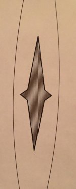

I've been playing around with my cad program today trying to come up with some sort of a design for the bottom of the canoe when I get that far, no bead and cove bits yet. I need to be doing something to keep myself occupied. Here is one design that I came up with, I am trying to get it to look like a campass needle, it is 6 ft long. Probably use ash and a 1/4" black walnut border strip around it. What you all think? Comments please, good or bad !

I also like the design !
I would opt for Aspen instead of Ash. It will stay white under the glass , and a big plus for Aspen, it's easier to sand than Ash.

I have changed my design of the compass needle a bit witch I like better.
I could not find any aspen wood for it, so I went to Lowes and got the lighted peace of poplar I could find, I am using poplar for the hole pattern, I am going to add a dark color to the shaded area of the needle.
