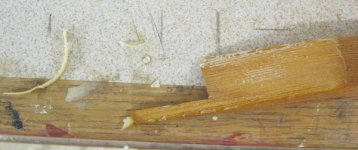

No Title
Douglas Fir outers in process. Very dry wood so we soaked them about 30 hours before installing tonight. Mostly. When Christy did the scarfs Saturday she used one of those new-fangled wood glues for the joints which was surprising since we normally use epoxy. So anyway, complete and utter failure of those joints. Mind you, soaking the one in boiling water may have added to it, but it just separated with the slightest pressure when trying to do the bend up. The glue also scraped off easy with a chisel. After they dry overnight I will epoxy them tomorrow and carry on Wednesday night.
The pieces of green tape on the inners mark which ribs are getting drilled so we don't mess that up. A screw every two ribs provides great clamping pressure for the canvas.

We messed up and put the scarfs at the ends and then when we tried to bend them, the first one snapped and the second one just musshed right in two with no effort at all. Which is surprising since karin was bending them pretty hard the other day. Note to self...always put scarfs in the middle.
Bottom line is they are on the boat and drying. It is starting to look pretty.
