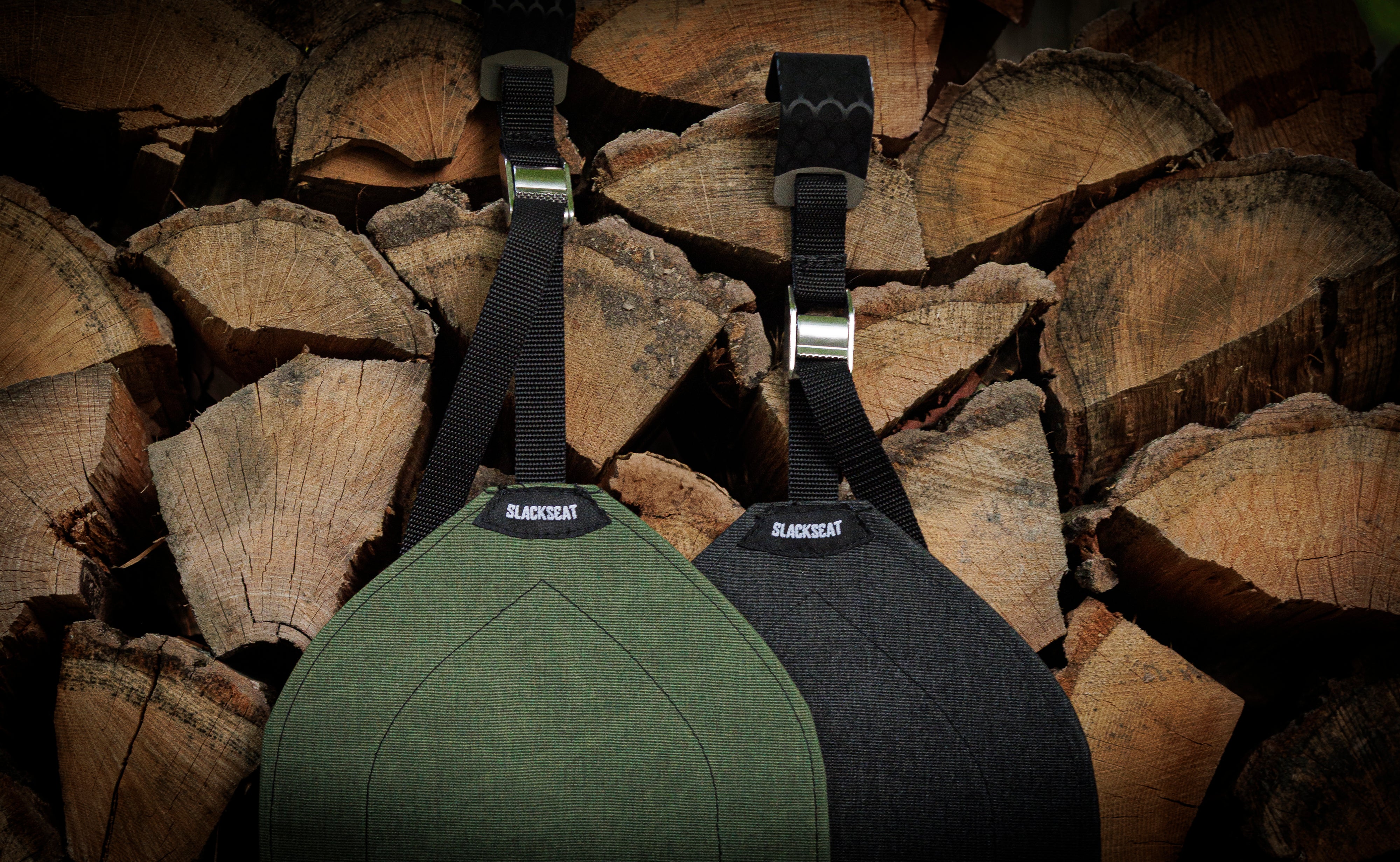

Has anyone tried a Slackseat?

This showed up in my inbox via a marketing email (perhaps the only one I actually enjoy getting - from the Outdoor Equipment Company). Has anyone given it a go? Perhaps there's a similar option that has already been discussed which I missed.
I’ve not seen that one but a friend has one made from leather that he buckles through his open gunnel. I might try making one if I can solve the hook part.
I have done many miles with a webbing/plastic buckle strap that did the same thing - kept the weight off my ankles and knees - and it was a good solution. Something wider and firmer would only be better, I suspect.
We used to call them 'trapper's seats' but I think there's an actual product that's taken that name.
$139 CAD!
Note the deficiencies pointed out in the one review on THIS SITE:
"Works really well. Wish I could make it tighter to lift me higher. After my knee surgery I can't flex fully so need my butt higher bit there's no strap left. I've had to adjust my stroke in prying for "J" since the hooks on the gunwhales interfere."
Examining the pictures, it appears that the strap on the straight-cut end is very short and nonadjustable. Thus, the seat seems to be usable only when you are scooted over to one side of the canoe, heeling. That is, you can't center the fabric seat on the straps.

Hey fellow paddlers––I'm the guy behind SlackSeat. I just discovered this thread today and wanted to join the conversation (albeit late).
Thanks to @scratchypants for sharing the link to my website and starting the conversation.
I went through a pile of iterations before landing on the one pictured above. I took the finished product to a Canadian-style paddling event, and in a group of about 50 paddlers, I sold my first 10 units. Since then, I've been surprised at the response in sales both on SlackSeat.com and COEC.
I'm working on the next iteration. It's helpful to read contentions. Everyone has their own paddling style, and not all knees and ankles are created equal. Overall, the response from people who have used SlackSeat has been validating. I have a few customers asking when I'll have stock again so they can order for students taking their ORCKA Basic Solo course.
Okay, but is SlackSeat as good as it could be?
I spent some time this afternoon thinking about @Glenn MacGrady's comments above, and it got me fiddling with straps and drawing pictures and considering how I could provide a little more customization to deal with the current catch-22. I have some ideas, but here's the tension:
SlackSeat is designed for solo paddlers who want to lean when they paddle. To provide comfort when paddling with the canoe heeled over, the paddling side of the seat "wants" to be as close to the gunnel as possible. I enjoy heeling my 16' Swift Algonquin to the point of nearly taking a sip of water over the gunnel. SlackSeat works great for this, and I think it's going to work even better on my next iteration.
But what to do when you want to paddle with less of a heel and sit centred? In my Swift, I can sit centered on SlackSeat no problem––I've designed the seat to be wide enough to accommodate that shift for someone with my sized arse (I'm not sure of the exact measurements of my arse). Sure, the seat itself is still closer to the paddling side, but the paddler can sit centered. The trade-off? In a more narrow canoe, you run out of strap a little sooner than you would in a wider canoe.
I'm eager for the spring thaw and will shoot more videos and photos to show SlackSeat in action. For now, at the end of this video you can see me shift towards the centre of the canoe.
Looking forward to more discussions, and please feel free to drop me a line with any questions or suggestions!
That makes sense if the only market you're after is solo paddling a wide tandem canoe in a heeled posture, which is much more common in Canada than the USA.
Heeling a big honker tandem for Canadian "style paddling" is a wonderful recreational and performative day sport on calm waters, as is American "freestyle paddling" in dedicated solo canoes. However, it is not ideal when carrying a tripping load or when paddling in wind, waves or rapids, or when you want to use cross-bow strokes. Therefore, most serious canoe trippers paddle their canoes level, on the design waterline rather on than the b*st*rdized, asymmetrical, watermelon slice waterline of a heeled canoe, except when they heel to enhance axle turns, post turns and sideslips.
It just seems to me that your product could have more market appeal if you had a model that (1) could be centralized between the gunwales and (2) also could be adjusted in height for different depth canoes and different sized feet.
For folks who only want to kneel in a heeled position and don't care about centralization or a level canoe, a solid Welsh Plank can easily be constructed for that purpose. Here's a video of one from that Charles Burchill hyperlink:
Thanks, @Glenn MacGrady. I've updated my location as suggested.
Yes, a Welsh plank aims at solving the same problem and for the same kind of paddling.
I think you're right about the wider market opportunity with those two points above. I wasn't joking––I think I have a solution for the first one, I just need to put it together.
I'll see your video of Burchill paddling with a Welsh Plank and raise you one of him paddling with a SlackSeat! 😉
Also, it's worth watching just to see what he can do in a Grumman.
