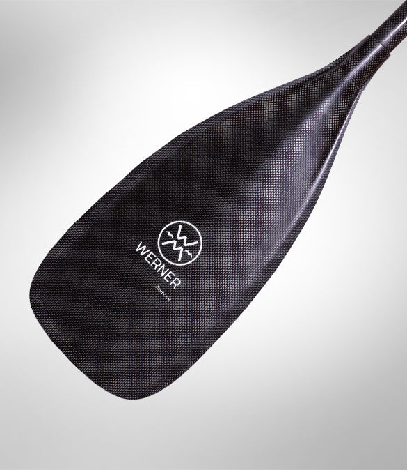

Thinking of making a carbon fiber paddle...
Feb 14, 2013
2,059
2,988
SW Idaho
....or maybe I should say, " assembling one".
I'm thinking about my winter projects, and the idea hit me that since I'm not likely to find a straight carbon paddle on the used market (all but one of my paddles were bought used) maybe I can make one. I read through a thread here about doing that, and decided I'm not up to doing it that way. Since I recently became aware of affordable carbon fiber tubing, another idea came to mind. I could carve a grip from a lightweight wood, match that to purchased tube, and all I would have to produce from carbon cloth would be the blade.
Sound feasible?
How would you go about fashioning that blade so that it could be plugged into the shaft with a snug fit and epoxy? I'm thinking of a Sugar Island style blade, slightly foil shaped but thin. Something that would be suitable as a mild river and meandering stream paddle to go with the Wildfire. I'd want it to be perfectly symmetrical.
Also, what wall thickness should I go with on the tubing? 1mm? 2mm? I should've measured the Zav when I had the grip off to shorten it.

Yes, that's the thread I was reading and I was actually hoping he would chime in. Although I don't have the setup to do it the way he showed, maybe he's experimented with a different approach. I'm sure he'd be helpful either way.
My latest idea is to carve a single side mold from balsa or basswood and make each face of the blade separately, then sandwich them together before attaching to the shaft.
Why not mold the blade right onto the shaft rather than make a blade then glue it to (into?) a shaft? I'd think it would be stronger this way, though maybe not significantly so? Maybe lighter, too, though again maybe not significantly so? A lot of possible construction variables for sure.
It's a good question. I haven't ruled it out. But I'd like to be able to eliminate any ridge at the paddle/shaft interface without having to feather it if possible. If I can get tubing with OD to match the ID of the main shaft, that might work.

The Journey is kinda what I have in mind and I'm not against buying it, but I thought I'd try this first...... unless someone puts one up for sale used. ;)
