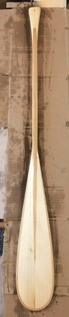

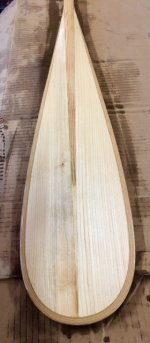

So an other paddle getting close to be delivered.... This one is going to a husband to be as a wedding gift from his wife(my client).... Sitka spruce, white ash!! I quite like that one!! Light but stiff, and with he ash blade trim and ash wear strip north and south on the shaft should make for a pretty hard waring combo!!
