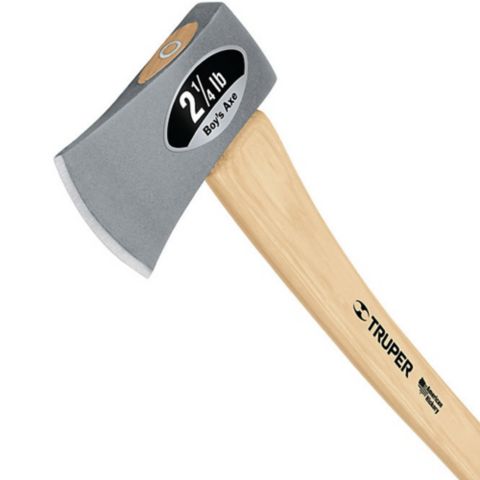

Tractor Supply wins the low price boys axe battle with a $15 axe from Truper.
4000109
The Truper looks very like the Collins, doesn't it. They probably are both made in China or Mexico. Maine's Snow & Peavey axes are now forged in China.

Oh, I can't let this pass. According to the following post on Bushcraft USA (after the asterisks), the poster found a Truper boys axe new at Tractor Supply with the head installed upside down.
A few weeks ago, I found this on the rack at the local tractor supply store.
It is a new boys axe by Truper Tools, I think out of Mexico.
For $20 you get one axe with such low quality control that they let people hang axe heads upside down. Really. Not only does one company make and sell such a disgrace, but another company tries to sell it to us. Atleast thy are only asking twenty bucks....
