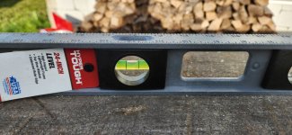

Finally starting my build thread after a long introduction post. I have the strong back done. The center seems to dip down some. I'll need to raise the center form a smidge. I had to work on my Rogue and the pad is a mess. I'll need to clean and tidy this area!
I'll show the level, perpendicular and parallel to the strong back here.
South end. A little lean here, the end leg isn't finished yet.
Center.
North end

I use a laser level for setting my forms so the strongback being level and straight isn't so important. It makes things pretty easy and you wouldn't believe all the uses you can find for it with other projects.
