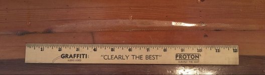

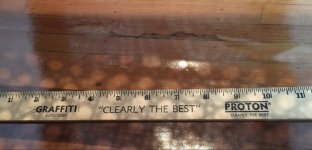

I finally got a chance to inspect A Slow Boat to Nowhere. I knew my mishap on the Penobscot River had put a good scratch on the outside near the bow but there was no interior damage there.
However, I did find two spots near the stern on the inside where the glass delaminaed and cracked. I see no exterior damage at these spots to the glass or the wood.
Seeking advice on the best technique to repair this damage.

There's already 1.5 layers of 6 oz S-glass inside and out. The extra half layer inside and out covers the "football" up to about the usual water line. These cracks are just above the usual water line.
Of course, when my canoe filled with water and went down the rapids like a submarine, the water line ended up at about the gunnels. :rolleyes:
I will see if other advice is forthcoming. Otherwise, I think I will cut out as much bad fiberglass as I can with a knife, sand the area smooth and lay in some patches after making sure the wood is still sound.
