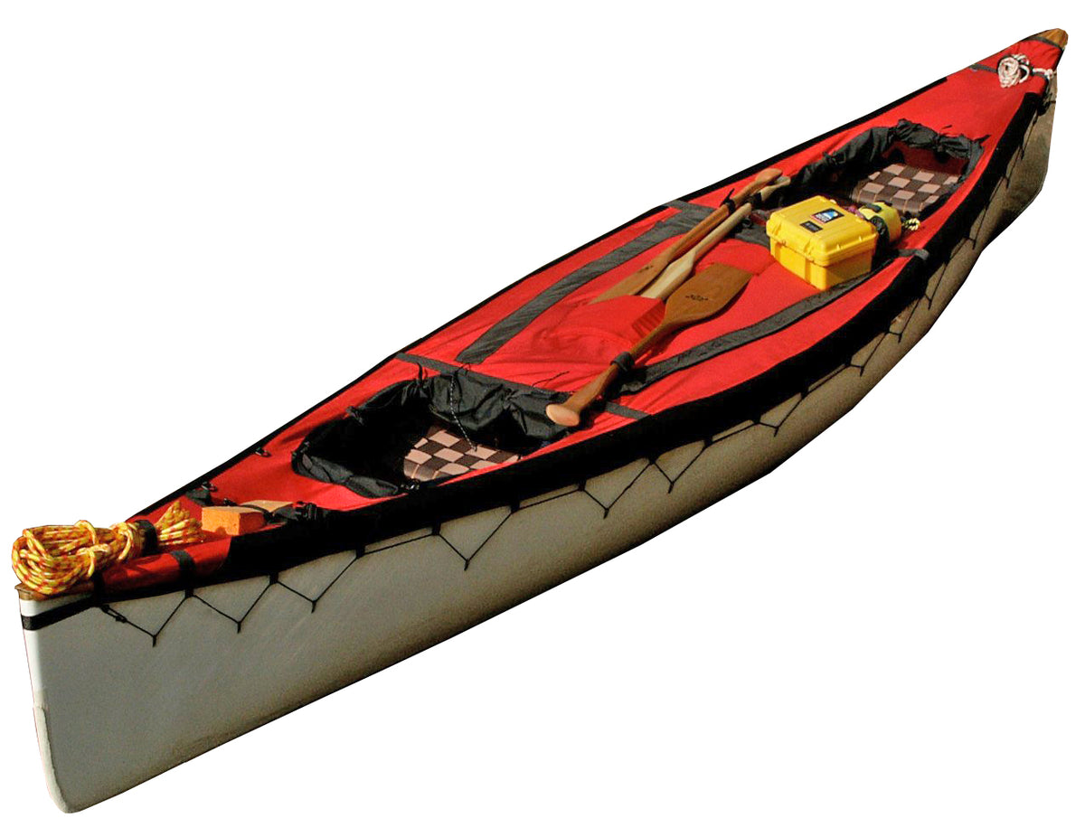

My next step was outfitting a spray cover. I settled on a North Water:
I selected the North Water because the attachment system afforded a lot of variance for how tightly the cover can be laced onto the canoe. I wanted to accommodate varying load heights above the gunwales. I do a group trip every year for which we tend to overpack. Because I outfit most of the group gear, organizing it all on the early days of the trip often means I'm the last to load my canoe. Just like a game of musical chairs, sometimes I end up with the extra item that just won't fit. Case in point, albeit in a different boat, here is me, stupidly overloaded on day one of the James River, before I offloaded a portion of the gear to some of our lily-dippers:
North Water was a pleasure to work with, they accommodated all my persnickety requests and helped guide me away from a couple bad ideas. They have an easy templating method that allows a quality fit for any canoe. I settled on a one-piece cover, with a single large portage cargo hatch in the center, and paddler cockpit skirts that could be kept rolled out of the way, most of the time. I worked with an incredibly knowledgeable guy named Morgan, who provided an initial sketch:

I talked Morgan through my notion about tall packing loads and he helped design an extra flap of fabric that could be tucked under the spray cover during normal use (i.e. reasonable packing) and then folded out and deployed for especially tall loads (i.e. my idiot loads). The second design iteration indicated how he would accomplish this. You'll see the extra flaps amidships, drawn in blue ballpoint pen:
In addition, I added paddle pockets for spare paddles, Velcro straps for painter lines, d-rings for map cases in front of each paddler position and a few extra anchor points.
I have a fondness for green canoes and my vanity precluded me from settling for one of North Water's standard colors (red and blue), so I asked for a custom option and Morgan obliged for a very reasonable $50 upcharge. The manufacturer of the PVC coated polyester had grey and beige as the additional options, so I went with beige. I think the combination of the faded-avocado-green hull and beige spray deck gives off Series I Land Rover vibes and I like it. Here's a photo of its initial sea trials, without the extra gear flaps deployed:
On the hull, you can see a couple squares of blue painters tape, which I used as a layout guide when drilling the holes for the lacing.
One final aesthetic consideration was plain black webbing along the cover's perimeter, rather than the standard webbing which is emblazoned with a repeating white "North Water" branding:

The spray cover is great. Very well made and sturdy. The PVC coated polyester is heavy gauge and waterproof (it will retain puddles in any low spot) but its not light. I've never weighed the cover, but it's not insignificant when portaging an 80 lb. canoe. I've already torn one of the paddle pockets but I admittedly put it under a lot of stress by strapping a spare paddle down over a lumpy load below.
Here's a picture showing a portion of the extra gear flap deployed, just to the left of the boots in the foreground.
