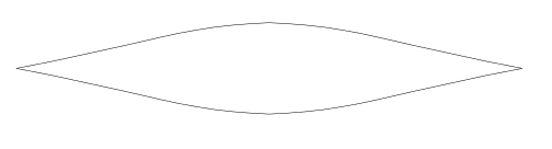

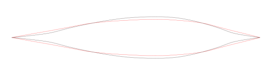

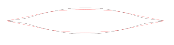

Just to make sure, is aft from widest point to rear of the boat and bow from widest point to front of boat? is half inch aft and 1,5 inch to bow for rocker enough? I prefer more tracking.
Does rocker have influence on speed of canoe?
here is symmetrical and asymmetrical hulls.
Edit: red line is gunwale width and black is from widest point

The widest point lines near the bow and stern have a pronounced curve, which as I understand it, is not going to be desirable for a boat design.
It will create turbulence as it pushes through the water, it should follow the same shape as the gunnel lines ..... longer, relatively straight portions as you approach the bow and stern allow the water to move away from the hull (bow), then move back (stern) cleanly, creating minimum drag.
To make a more relevant assessment, you need to show us the design displacement waterline.
That abrupt black line would cause poor performance if that's the waterline...
