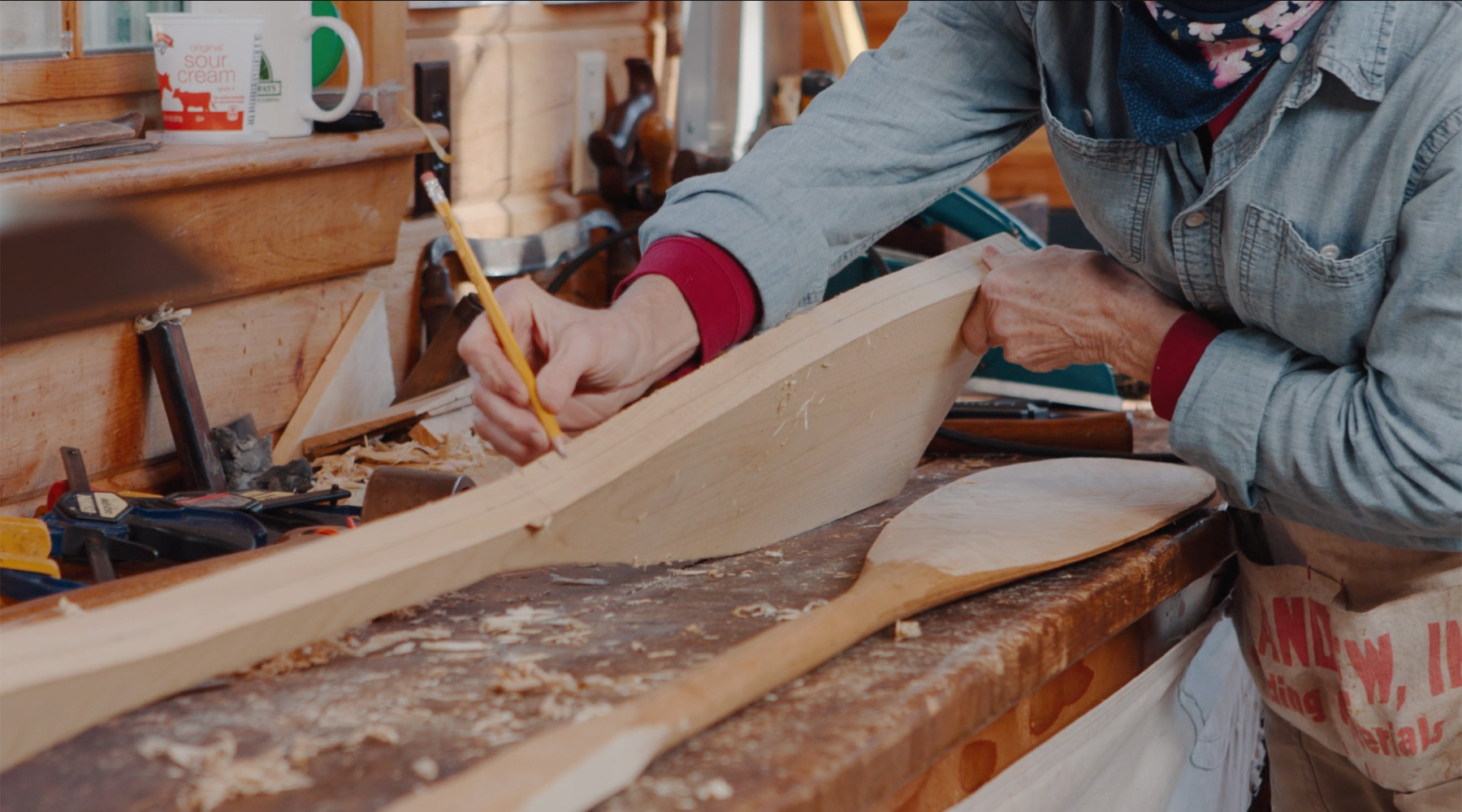

Of course, the north woods stroke is classically done with a stepped, secondary grip, north woods-style paddle. Here's an article with video on how to make one:
