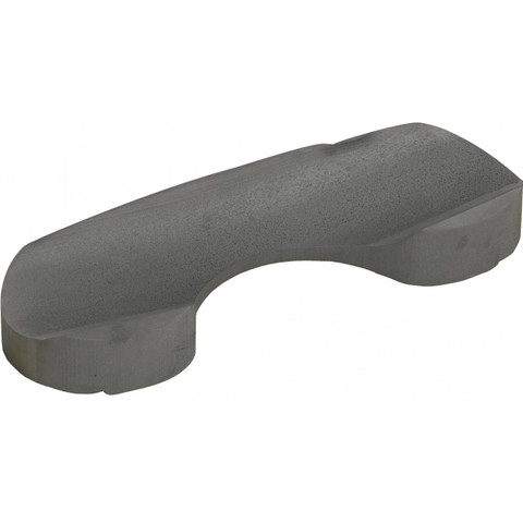

Some folks just buy a wooden solo yoke and then glue on minicel cushions that they shape to their personal shoulder sizes by carving and sanding. You can even buy them:

Erica, not an off-the-shelf solution, but for ultralight solos I start off with a Wenonah laminated tandem yoke, cut to fit, locate the holes and fab up clamps from wood (like Memaquay). The Wenonah yoke has a vertical contour and allows you to mount the pads at an angle to match your trapezius muscles. Because the laminated yoke is so strong, I usually cut lightening holes along the length. SAM_1620 (2).JPG
