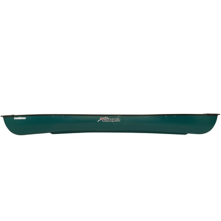

Here's a picture of a new one. It's 15-6 long and 42" abeam. A canoe with that that wide a L/W ratio will be hard to paddle straight. So they designed in two gimmicks to help it go straight. The keel line is hogged so the bow and stern will pin in the water, and there is a deep keel. It will plow through the water, slowly.
