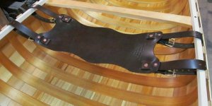

Clever work, and nice details in the canoe as well!
While not precisely within the parameters of your post, take a look at this...
Could be used in a stripper with slotted gunwales as well. I suppose it's intended as a kneeler's rest rather than a seat strictly. https://azlandtraditions.com
Now that looks comfy ! I'd have to make mine webbing and nylon, as I have a tendency to get things too wet. I'd also need to beef up my inwhales.
Quite appropriate on a wood canvas hull !
The thwart adds enough stiffness and support ! I like it !
